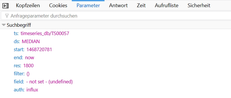

Hi @Chris M.,
auf dem Wiregate läuft eine 0.10.2.
Anfrage:
Das Popup:
Und als Antwort dann eine Endlosstrom:
unten dran dann:
[[1468719000000,[""]],[1468720800000,[""]],[1468722600000,[""]],[1468724400000,[""]],[1468726200000,[""]],[1468728000000,[""]],[1468729800000,[""]],[1468731600000,[""]],[1468733400000,[""]],[1468735200000,[""]],[1468737000000,[""]],[1468738800000,[""]],[1468740600000,[""]],[1468742400000,[""]],[1468744200000,[""]],[1468746000000,["22.805378"]],[1468747800000,[""]],[1468749600000,[""]],[1468751400000,[""]],[1468753200000,[""]],[1468755000000,[""]],[1468756800000,[""]],[1468758600000,[""]],[1468760400000,[""]],[1468762200000,[""]],[1468764000000,[""]],[1468765800000,[""]],[1468767600000,[""]],[1468769400000,[""]],[1468771200000,[""]],[1468773000000,[""]],[1468774800000,[""]],[1468776600000,[""]],[1468778400000,[""]],[1468780200000,[""]],[1468782000000,[""]],[1468783800000,[""]],[1468785600000,[""]],[1468787400000,[""]],[1468789200000,[""]],[1468791000000,[""]],[1468792800000,[""]],[1468794600000,[""]],[1468796400000,[""]],[1468798200000,[""]],[1468800000000,["26.727272"]],[1468801800000,[""]],[1468803600000,[""]],[1468805400000,[""]],[1468807200000,[""]],[1468809000000,[""]],[1468810800000,[""]],[1468812600000,[""]],[1468814400000,[""]],[1468816200000,[""]],[1468818000000,[""]],[1468819800000,[""]],[1468821600000,[""]],[1468823400000,[""]],[1468825200000,[""]],[1468827000000,[""]],[1468828800000,[""]],[1468830600000,[""]],[1468832400000,[""]],[1468834200000,[""]],[1468836000000,[""]],[1468837800000,[""]],[1468839600000,[""]],[1468841400000,[""]],[1468843200000,[""]],[1468845000000,[""]],[1468846800000,[""]],[1468848600000,[""]],[1468850400000,[""]],[1468852200000,[""]],[1468854000000,["24.795132"]],[1468855800000,[""]],[1468857600000,[""]],[1468859400000,[""]],[1468861200000,[""]],[1468863000000,[""]],[1468864800000,[""]],[1468866600000,[""]],[1468868400000,[""]],[1468870200000,[""]],[1468872000000,[""]],[1468873800000,[""]],[1468875600000,[""]],[1468877400000,[""]],[1468879200000,[""]],[1468881000000,[""]],[1468882800000,[""]],[1468884600000,[""]],[1468886400000,[""]],[1468888200000,[""]],[1468890000000,[""]],[1468891800000,[""]],[1468893600000,[""]],[1468895400000,[""]],[1468897200000,[""]],[1468899000000,[""]],[1468900800000,[""]],[1468902600000,[""]],[1468904400000,[""]],[1468906200000,[""]],[1468908000000,["26.437372"]],[1468909800000,[""]],[1468911600000,[""]],[1468913400000,[""]],[1468915200000,[""]],[1468917000000,[""]],[1468918800000,[""]],[1468920600000,[""]],[1468922400000,[""]],[1468924200000,[""]],[1468926000000,[""]],[1468927800000,[""]],[1468929600000,[""]],[1468931400000,[""]],[1468933200000,[""]],[1468935000000,[""]],[1468936800000,[""]],[1468938600000,[""]],[1468940400000,[""]],[1468942200000,[""]],[1468944000000,[""]],[1468945800000,[""]],[1468947600000,[""]],[1468949400000,[""]],[1468951200000,[""]],[1468953000000,[""]],[1468954800000,[""]],[1468956600000,[""]],[1468958400000,[""]],[1468960200000,[""]],[1468962000000,["31.206241"]],[1468963800000,[""]],[1468965600000,[""]],[1468967400000,[""]],[1468969200000,[""]],[1468971000000,[""]],[1468972800000,[""]],[1468974600000,[""]],[1468976400000,[""]],[1468978200000,[""]],[1468980000000,[""]],[1468981800000,[""]],[1468983600000,[""]],[1468985400000,[""]],[1468987200000,[""]],[1468989000000,[""]],[1468990800000,[""]],[1468992600000,[""]],[1468994400000,[""]],[1468996200000,[""]],[1468998000000,[""]],[1468999800000,[""]],[1469001600000,[""]],[1469003400000,[""]],[1469005200000,[""]],[1469007000000,[""]],[1469008800000,[""]],[1469010600000,[""]],[1469012400000,[""]],[1469014200000,[""]],[1469016000000,["26.761496"]],[1469017800000,[""]],[1469019600000,[""]],[1469021400000,[""]],[1469023200000,[""]],[1469025000000,[""]],[1469026800000,[""]],[1469028600000,[""]],[1469030400000,[""]],[1469032200000,[""]],[1469034000000,[""]],[1469035800000,[""]],[1469037600000,[""]],[1469039400000,[""]],[1469041200000,[""]],[1469043000000,[""]],[1469044800000,[""]],[1469046600000,[""]],[1469048400000,[""]],[1469050200000,[""]],[1469052000000,[""]],[1469053800000,[""]],[1469055600000,[""]],[1469057400000,[""]],[1469059200000,[""]],[1469061000000,[""]],[1469062800000,[""]],[1469064600000,[""]],[1469066400000,[""]],[1469068200000,[""]],[1469070000000,["32.060614"]],[1469071800000,[""]],[1469073600000,[""]],[1469075400000,[""]],[1469077200000,[""]],[1469079000000,[""]],[1469080800000,[""]],[1469082600000,[""]],[1469084400000,[""]],[1469086200000,[""]],[1469088000000,[""]],[1469089800000,[""]],[1469091600000,[""]],[1469093400000,[""]],[1469095200000,[""]],[1469097000000,[""]],[1469098800000,[""]],[1469100600000,[""]],[1469102400000,[""]],[1469104200000,[""]],[1469106000000,[""]],[1469107800000,[""]],[1469109600000,[""]],[1469111400000,[""]],[1469113200000,[""]],[1469115000000,[""]],[1469116800000,[""]],[1469118600000,[""]],[1469120400000,[""]],[1469122200000,[""]],[1469124000000,["30.102878"]],[1469125800000,[""]],[1469127600000,[""]],[1469129400000,[""]],[1469131200000,[""]],[1469133000000,[""]],[1469134800000,[""]],[1469136600000,[""]],[1469138400000,[""]],[1469140200000,[""]],[1469142000000,[""]],[1469143800000,[""]],[1469145600000,[""]],[1469147400000,[""]],[1469149200000,[""]],[1469151000000,[""]],[1469152800000,[""]],[1469154600000,[""]],[1469156400000,[""]],[1469158200000,[""]],[1469160000000,[""]],[1469161800000,[""]],[1469163600000,[""]],[1469165400000,[""]],[1469167200000,[""]],[1469169000000,[""]],[1469170800000,[""]],[1469172600000,[""]],[1469174400000,[""]],[1469176200000,[""]],[1469178000000,["25.954117"]],[1469179800000,[""]],[1469181600000,[""]],[1469183400000,[""]],[1469185200000,[""]],[1469187000000,[""]],[1469188800000,[""]],[1469190600000,[""]],[1469192400000,[""]],[1469194200000,[""]],[1469196000000,[""]],[1469197800000,[""]],[1469199600000,[""]],[1469201400000,[""]],[1469203200000,[""]],[1469205000000,[""]],[1469206800000,[""]],[1469208600000,[""]],[1469210400000,[""]],[1469212200000,[""]],[1469214000000,[""]],[1469215800000,[""]],[1469217600000,[""]],[1469219400000,[""]],[1469221200000,[""]],[1469223000000,[""]],[1469224800000,[""]],[1469226600000,[""]],[1469228400000,[""]],[1469230200000,[""]],[1469232000000,["29.621675"]],[1469233800000,[""]],[1469235600000,[""]],[1469237400000,[""]],[1469239200000,[""]],[1469241000000,[""]],[1469242800000,[""]],[1469244600000,[""]],[1469246400000,[""]],[1469248200000,[""]],[1469250000000,[""]],[1469251800000,[""]],[1469253600000,[""]],[1469255400000,[""]],[1469257200000,[""]],[1469259000000,[""]],[1469260800000,[""]],[1469262600000,[""]],[1469264400000,[""]],[1469266200000,[""]],[1469268000000,[""]],[1469269800000,[""]],[1469271600000,[""]],[1469273400000,[""]],[1469275200000,[""]],[1469277000000,[""]],[1469278800000,[""]],[1469280600000,[""]],[1469282400000,[""]],[1469284200000,[""]],[1469286000000,["26.118899"]],[1469287800000,[""]],[1469289600000,[""]],[1469291400000,[""]],[1469293200000,[""]],[1469295000000,[""]],[1469296800000,[""]],[1469298600000,[""]],[1469300400000,[""]],[1469302200000,[""]],[1469304000000,[""]],[1469305800000,[""]],[1469307600000,[""]],[1469309400000,[""]],[1469311200000,[""]],[1469313000000,[""]],[1469314800000,[""]],[1469316600000,[""]],[1469318400000,[""]],[1469320200000,[""]],[1469322000000,[""]],[1469323800000,[""]],[1469325600000,[""]],[1469327400000,[""]],[1469329200000,[""]],[1469331000000,[""]],[1469332800000,[""]],[1469334600000,[""]],[1469336400000,[""]],[1469338200000,[""]],[1469340000000,["23.946078"]],[1469341800000,[""]],[1469343600000,[""]],[1469345400000,[""]],[1469347200000,[""]],[1469349000000,[""]],[1469350800000,[""]],[1469352600000,[""]],[1469354400000,[""]],[1469356200000,[""]],[1469358000000,[""]],[1469359800000,[""]],[1469361600000,[""]],[1469363400000,[""]],[1469365200000,[""]],[1469367000000,[""]],[1469368800000,[""]],[1469370600000,[""]],[1469372400000,[""]],[1469374200000,[""]],[1469376000000,[""]],[1469377800000,[""]],[1469379600000,[""]],[1469381400000,[""]],[1469383200000,[""]],[1469385000000,[""]],[1469386800000,[""]],[1469388600000,[""]],[1469390400000,[""]],[1469392200000,[""]],[1469394000000,["27.498608"]],[1469395800000,[""]],[1469397600000,[""]],[1469399400000,[""]],[1469401200000,[""]],[1469403000000,[""]],[1469404800000,[""]],[1469406600000,[""]],[1469408400000,[""]],[1469410200000,[""]],[1469412000000,[""]],[1469413800000,[""]],[1469415600000,[""]],[1469417400000,[""]],[1469419200000,[""]],[1469421000000,[""]],[1469422800000,[""]],[1469424600000,[""]],[1469426400000,[""]],[1469428200000,[""]],[1469430000000,[""]],[1469431800000,[""]],[1469433600000,[""]],[1469435400000,[""]],[1469437200000,[""]],[1469439000000,[""]],[1469440800000,[""]],[1469442600000,[""]],[1469444400000,[""]],[1469446200000,[""]],[1469448000000,["25.140701"]],[1469449800000,[""]],[1469451600000,[""]],[1469453400000,[""]],[1469455200000,[""]],[1469457000000,[""]],[1469458800000,[""]],[1469460600000,[""]],[1469462400000,[""]],[1469464200000,[""]],[1469466000000,[""]],[1469467800000,[""]],[1469469600000,[""]],[1469471400000,[""]],[1469473200000,[""]],[1469475000000,[""]],[1469476800000,[""]],[1469478600000,[""]],[1469480400000,[""]],[1469482200000,[""]],[1469484000000,[""]],[1469485800000,[""]],[1469487600000,[""]],[1469489400000,[""]],[1469491200000,[""]],[1469493000000,[""]],[1469494800000,[""]],[1469496600000,[""]],[1469498400000,[""]],[1469500200000,[""]],[1469502000000,["27.03456"]],[1469503800000,[""]],[1469505600000,[""]],[1469507400000,[""]],[1469509200000,[""]],[1469511000000,[""]],[1469512800000,[""]],[1469514600000,[""]],[1469516400000,[""]],[1469518200000,[""]],[1469520000000,[""]],[1469521800000,[""]],[1469523600000,[""]],[1469525400000,[""]],[1469527200000,[""]],[1469529000000,[""]],[1469530800000,[""]],[1469532600000,[""]],[1469534400000,[""]],[1469536200000,[""]],[1469538000000,[""]],[1469539800000,[""]],[1469541600000,[""]],[1469543400000,[""]],[1469545200000,[""]],[1469547000000,[""]],[1469548800000,[""]],[1469550600000,[""]],[1469552400000,[""]],[1469554200000,[""]],[1469556000000,["25.286777"]],[1469557800000,[""]],[1469559600000,[""]],[1469561400000,[""]],[1469563200000,[""]],[1469565000000,[""]],[1469566800000,[""]],[1469568600000,[""]],[1469570400000,[""]],[1469572200000,[""]],[1469574000000,[""]],[1469575800000,[""]],[1469577600000,[""]],[1469579400000,[""]],[1469581200000,[""]],[1469583000000,[""]],[1469584800000,[""]],[1469586600000,[""]],[1469588400000,[""]],[1469590200000,[""]],[1469592000000,[""]],[1469593800000,[""]],[1469595600000,[""]],[1469597400000,[""]],[1469599200000,[""]],[1469601000000,[""]],[1469602800000,[""]],[1469604600000,[""]],[1469606400000,[""]],[1469608200000,[""]],[1469610000000,["20.909169"]],[1469611800000,[""]],[1469613600000,[""]],[1469615400000,[""]],[1469617200000,[""]],[1469619000000,[""]],[1469620800000,[""]],[1469622600000,[""]],[1469624400000,[""]],[1469626200000,[""]],[1469628000000,[""]],[1469629800000,[""]],[1469631600000,[""]],[1469633400000,[""]],[1469635200000,[""]],[1469637000000,[""]],[1469638800000,[""]],[1469640600000,[""]],[1469642400000,[""]],[1469644200000,[""]],[1469646000000,[""]],[1469647800000,[""]],[1469649600000,[""]],[1469651400000,[""]],[1469653200000,[""]],[1469655000000,[""]],[1469656800000,[""]],[1469658600000,[""]],[1469660400000,[""]],[1469662200000,[""]],[1469664000000,["25.273594"]],[1469665800000,[""]],[1469667600000,[""]],[1469669400000,[""]],[1469671200000,[""]],[1469673000000,[""]],[1469674800000,[""]],[1469676600000,[""]],[1469678400000,[""]],[1469680200000,[""]],[1469682000000,[""]],[1469683800000,[""]],[1469685600000,[""]],[1469687400000,[""]],[1469689200000,[""]],[1469691000000,[""]],[1469692800000,[""]],[1469694600000,[""]],[1469696400000,[""]],[1469698200000,[""]],[1469700000000,[""]],[1469701800000,[""]],[1469703600000,[""]],[1469705400000,[""]],[1469707200000,[""]],[1469709000000,[""]],[1469710800000,[""]],[1469712600000,[""]],[1469714400000,[""]],[1469716200000,[""]],[1469718000000,["22.159106"]],[1469719800000,[""]],[1469721600000,[""]],[1469723400000,[""]],[1469725200000,[""]],[1469727000000,[""]],[1469728800000,[""]],[1469730600000,[""]],[1469732400000,[""]],[1469734200000,[""]],[1469736000000,[""]],[1469737800000,[""]],[1469739600000,[""]],[1469741400000,[""]],[1469743200000,[""]],[1469745000000,[""]],[1469746800000,[""]],[1469748600000,[""]],[1469750400000,[""]],[1469752200000,[""]],[1469754000000,[""]],[1469755800000,[""]],[1469757600000,[""]],[1469759400000,[""]],[1469761200000,[""]],[1469763000000,[""]],[1469764800000,[""]],[1469766600000,[""]],[1469768400000,[""]],[1469770200000,[""]],[1469772000000,["21.644475"]],[1469773800000,[""]],[1469775600000,[""]],[1469777400000,[""]],[1469779200000,[""]],[1469781000000,[""]],[1469782800000,[""]],[1469784600000,[""]],[1469786400000,[""]],[1469788200000,[""]],[1469790000000,[""]],[1469791800000,[""]],[1469793600000,[""]],[1469795400000,[""]],[1469797200000,[""]],[1469799000000,[""]],[1469800800000,[""]],[1469802600000,[""]],[1469804400000,[""]],[1469806200000,[""]],[1469808000000,[""]],[1469809800000,[""]],[1469811600000,[""]],[1469813400000,[""]],[1469815200000,[""]],[1469817000000,[""]],[1469818800000,[""]],[1469820600000,[""]],[1469822400000,[""]],[1469824200000,[""]],[1469826000000,["22.846035"]],[1469827800000,[""]],[1469829600000,[""]],[1469831400000,[""]],[1469833200000,[""]],[1469835000000,[""]],[1469836800000,[""]],[1469838600000,[""]],[1469840400000,[""]],[1469842200000,[""]],[1469844000000,[""]],[1469845800000,[""]],[1469847600000,[""]],[1469849400000,[""]],[1469851200000,[""]],[1469853000000,[""]],[1469854800000,[""]],[1469856600000,[""]],[1469858400000,[""]],[1469860200000,[""]],[1469862000000,[""]],[1469863800000,[""]],[1469865600000,[""]],[1469867400000,[""]],[1469869200000,[""]],[1469871000000,[""]],[1469872800000,[""]],[1469874600000,[""]],[1469876400000,[""]],[1469878200000,[""]],[1469880000000,["21.771289"]],[1469881800000,[""]],[1469883600000,[""]],[1469885400000,[""]],[1469887200000,[""]],[1469889000000,[""]],[1469890800000,[""]],[1469892600000,[""]],[1469894400000,[""]],[1469896200000,[""]],[1469898000000,[""]],[1469899800000,[""]],[1469901600000,[""]],[1469903400000,[""]],[1469905200000,[""]],[1469907000000,[""]],[1469908800000,[""]],[1469910600000,[""]],[1469912400000,[""]],[1469914200000,[""]],[1469916000000,[""]],[1469917800000,[""]],[1469919600000,[""]],[1469921400000,[""]],[1469923200000,[""]],[1469925000000,[""]],[1469926800000,[""]],[1469928600000,[""]],[1469930400000,[""]],[1469932200000,[""]],[1469934000000,["23.282366"]],[1469935800000,[""]],[1469937600000,[""]],[1469939400000,[""]],[1469941200000,[""]],[1469943000000,[""]],[1469944800000,[""]],[1469946600000,[""]],[1469948400000,[""]],[1469950200000,[""]],[1469952000000,[""]],[1469953800000,[""]],[1469955600000,[""]],[1469957400000,[""]],[1469959200000,[""]],[1469961000000,[""]],[1469962800000,[""]],[1469964600000,[""]],[1469966400000,[""]],[1469968200000,[""]],[1469970000000,[""]],[1469971800000,[""]],[1469973600000,[""]],[1469975400000,[""]],[1469977200000,[""]],[1469979000000,[""]],[1469980800000,[""]],[1469982600000,[""]],[1469984400000,[""]],[1469986200000,[""]],[1469988000000,["20.917963"]],[1469989800000,[""]],[1469991600000,[""]],[1469993400000,[""]],[1469995200000,[""]],[1469997000000,[""]],[1469998800000,[""]],[1470000600000,[""]],[1470002400000,[""]],[1470004200000,[""]],[1470006000000,[""]],[1470007800000,[""]],[1470009600000,[""]],[1470011400000,[""]],[1470013200000,[""]],[1470015000000,[""]],[1470016800000,[""]],[1470018600000,[""]],[1470020400000,[""]],[1470022200000,[""]],[1470024000000,[""]],[1470025800000,[""]],[1470027600000,[""]],[1470029400000,[""]],[1470031200000,[""]],[1470033000000,[""]],[1470034800000,[""]],[1470036600000,[""]],[1470038400000,[""]],[1470040200000,[""]],[1470042000000,["17.314975"]],[1470043800000,[""]],[1470045600000,[""]],[1470047400000,[""]],[1470049200000,[""]],[1470051000000,[""]],[1470052800000,[""]],[1470054600000,[""]],[1470056400000,[""]],[1470058200000,[""]],[1470060000000,[""]],[1470061800000,[""]],[1470063600000,[""]],[1470065400000,[""]],[1470067200000,[""]],[1470069000000,[""]],[1470070800000,[""]],[1470072600000,[""]],[1470074400000,[""]],[1470076200000,[""]],[1470078000000,[""]],[1470079800000,[""]],[1470081600000,[""]],[1470083400000,[""]],[1470085200000,[""]],[1470087000000,[""]],[1470088800000,[""]],[1470090600000,[""]],[1470092400000,[""]],[1470094200000,[""]],[1470096000000,["23.712818"]],[1470097800000,[""]],[1470099600000,[""]],[1470101400000,[""]],[1470103200000,[""]],[1470105000000,[""]],[1470106800000,[""]],[1470108600000,[""]],[1470110400000,[""]],[1470112200000,[""]],[1470114000000,[""]],[1470115800000,[""]],[1470117600000,[""]],[1470119400000,[""]],[1470121200000,[""]],[1470123000000,[""]],[1470124800000,[""]],[1470126600000,[""]],[1470128400000,[""]],[1470130200000,[""]],[1470132000000,[""]],[1470133800000,[""]],[1470135600000,[""]],[1470137400000,[""]],[1470139200000,[""]],[1470141000000,[""]],[1470142800000,[""]],[1470144600000,[""]],[1470146400000,[""]],[1470148200000,[""]],[1470150000000,["18.578705"]],[1470151800000,[""]],[1470153600000,[""]],[1470155400000,[""]],[1470157200000,[""]],[1470159000000,[""]],[1470160800000,[""]],[1470162600000,[""]],[1470164400000,[""]],[1470166200000,[""]],[1470168000000,[""]],[1470169800000,[""]],[1470171600000,[""]],[1470173400000,[""]],[1470175200000,[""]],[1470177000000,[""]],[1470178800000,[""]],[1470180600000,[""]],[1470182400000,[""]],[1470184200000,[""]],[1470186000000,[""]],[1470187800000,[""]],[1470189600000,[""]],[1470191400000,[""]],[1470193200000,[""]],[1470195000000,[""]],[1470196800000,[""]],[1470198600000,[""]],[1470200400000,[""]],[1470202200000,[""]],[1470204000000,["18.593139"]],[1470205800000,[""]],[1470207600000,[""]],[1470209400000,[""]],[1470211200000,[""]],[1470213000000,[""]],[1470214800000,[""]],[1470216600000,[""]],[1470218400000,[""]],[1470220200000,[""]],[1470222000000,[""]],[1470223800000,[""]],[1470225600000,[""]],[1470227400000,[""]],[1470229200000,[""]],[1470231000000,[""]],[1470232800000,[""]],[1470234600000,[""]],[1470236400000,[""]],[1470238200000,[""]],[1470240000000,[""]],[1470241800000,[""]],[1470243600000,[""]],[1470245400000,[""]],[1470247200000,[""]],[1470249000000,[""]],[1470250800000,[""]],[1470252600000,[""]],[1470254400000,[""]],[1470256200000,[""]],[1470258000000,["20.287355"]],[1470259800000,[""]],[1470261600000,[""]],[1470263400000,[""]],[1470265200000,[""]],[1470267000000,[""]],[1470268800000,[""]],[1470270600000,[""]],[1470272400000,[""]],[1470274200000,[""]],[1470276000000,[""]],[1470277800000,[""]],[1470279600000,[""]],[1470281400000,[""]],[1470283200000,[""]],[1470285000000,[""]],[1470286800000,[""]],[1470288600000,[""]],[1470290400000,[""]],[1470292200000,[""]],[1470294000000,[""]],[1470295800000,[""]],[1470297600000,[""]],[1470299400000,[""]],[1470301200000,[""]],[1470303000000,[""]],[1470304800000,[""]],[1470306600000,[""]],[1470308400000,[""]],[1470310200000,[""]],[1470312000000,["19.673793"]],[1470313800000,[""]],[1470315600000,[""]],[1470317400000,[""]],[1470319200000,[""]],[1470321000000,[""]],[1470322800000,[""]],[1470324600000,[""]],[1470326400000,[""]],[1470328200000,[""]],[1470330000000,[""]],[1470331800000,[""]],[1470333600000,[""]],[1470335400000,[""]],[1470337200000,[""]],[1470339000000,[""]],[1470340800000,[""]],[1470342600000,[""]],[1470344400000,[""]],[1470346200000,[""]],[1470348000000,[""]],[1470349800000,[""]],[1470351600000,[""]],[1470353400000,[""]],[1470355200000,[""]],[1470357000000,[""]],[1470358800000,[""]],[1470360600000,[""]],[1470362400000,[""]],[1470364200000,[""]],[1470366000000,["19.579289"]],[1470367800000,[""]],[1470369600000,[""]],[1470371400000,[""]],[1470373200000,[""]],[1470375000000,[""]],[1470376800000,[""]],[1470378600000,[""]],[1470380400000,[""]],[1470382200000,[""]],[1470384000000,[""]],[1470385800000,[""]],[1470387600000,[""]],[1470389400000,[""]],[1470391200000,[""]],[1470393000000,[""]],[1470394800000,[""]],[1470396600000,[""]],[1470398400000,[""]],[1470400200000,[""]],[1470402000000,[""]],[1470403800000,[""]],[1470405600000,[""]],[1470407400000,[""]],[1470409200000,[""]],[1470411000000,[""]],[1470412800000,[""]],[1470414600000,[""]],[1470416400000,[""]],[1470418200000,[""]],[1470420000000,["19.61392"]],[1470421800000,[""]],[1470423600000,[""]],[1470425400000,[""]],[1470427200000,[""]],[1470429000000,[""]],[1470430800000,[""]],[1470432600000,[""]],[1470434400000,[""]],[1470436200000,[""]],[1470438000000,[""]],[1470439800000,[""]],[1470441600000,[""]],[1470443400000,[""]],[1470445200000,[""]],[1470447000000,[""]],[1470448800000,[""]],[1470450600000,[""]],
Dann ist irgendwann der ganze Browser in die ewigen Jagdgründe...
Egal was ich versuche, ich bekomme keine Daten im Diagramm links vom zu sehenden ersten Datenpunkt zu sehen.
Wenn ich in kleineren Dimensionen Details besorgen soll, gib mir bitte noch mal einen Ping.

Ne, lass gut sein. Ich kann das Problem ja nachstellen :)
Und es ist ein Thema 0.10.2 <-> 0.11-dev und keines RRD <-> InfluxDB.
