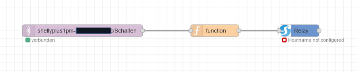

danke für den Hinweis. Hier mit dem Shelly Knoten:
Der Flow:
[{"id":"7a728150.0412b8","type":"mqtt in","z":"d9aafb38.150928","name":"","topic":"shellyplus1pm-xxx/Schalten","qos":"2","datatype":"auto","broker":"d457a115.b395e","x":270,"y":160,"wires":[["f3b14277.a6727"]]},{"id":"f3b14277.a6727","type":"function","z":"d9aafb38.150928","name":"","func":"let adr = msg.topic.split(/\\//);\nlet wert; \nswitch (msg.payload) {\n case true:\n case 1:\n case \"on\":\n case \"true\":\n wert = true\n break;\n case false:\n case 0:\n case \"off\":\n case \"false\":\n wert = false\n}\nnachricht = {\n hostname: adr[0],\n method: \"Switch.Set\",\n parameters : {\n id : 0,\n on : wert,\n }\n};\n\nmsg.payload = nachricht;\nreturn msg;","outputs":1,"noerr":0,"initialize":"","finalize":"","x":600,"y":160,"wires":[["e21bda9d.279af"]]},{"id":"e21bda9d.279af","type":"shelly-gen2","z":"d9aafb38.150928","hostname":"","description":"","mode":"polling","server":"04263f2d054cc2a1","uploadretryinterval":"5000","pollinginterval":5000,"pollstatus":false,"getstatusoncommand":false,"devicetype":"Relay","outputs":1,"x":810,"y":160,"wires":[[]]},{"id":"d457a115.b395e","type":"mqtt-broker","name":"ZuHause","broker":"192.168.2.62","port":"1883","clientid":"","usetls":false,"compatmode":false,"keepalive":"60","cleansession":true,"birthTopic":"","birthQos":"0","birthPayload":"","closeTopic":"","closeQos":"0","closePayload":"","willTopic":"","willQos":"0","willPayload":""},{"id":"04263f2d054cc2a1","type":"shelly-gen2-server","port":"10001","hostname":"unimatrix"}]
Der Flow:
