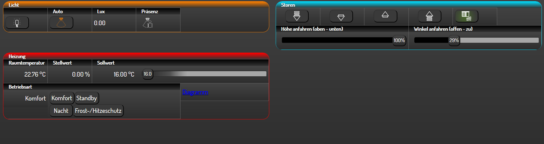

Ich habe es bei mir so gelöst:
        <group align="left" flavour="antimony" name="Storen">
          <layout colspan="6"/>
          <trigger value="1" mapping="AufAbSymbol" align="center">
            <layout colspan="1"/>
            <address transform="DPT:1.008" mode="readwrite">4/1/33</address>
          </trigger>
          <trigger value="1" mapping="HaltSymbol" align="center">
            <address transform="DPT:1.001" mode="readwrite">4/2/33</address>
          </trigger>
          <trigger value="0" mapping="HaltSymbol" align="center">
          </trigger>
          <trigger value="0" mapping="AufAbSymbol" align="center">
          </trigger>
          <switch on_value="1" off_value="0" mapping="StorenAutomatik" styling="GreenRed">
            <address transform="DPT:1.001" mode="readwrite">4/7/233</address>
            <address transform="DPT:1.001" mode="read">4/0/125</address>
            <address transform="DPT:1.001" mode="read">4/0/105</address>
          </switch>
          <info mapping="StorenHoehe">
            <address transform="DPT:5.001" mode="read">4/3/133</address>
          </info>
          <group flavour="black" nowidget="true" name="Höhe anfahren (oben - unten)">
            <layout colspan="3"/>
            <slide min="0" max="100" step="1" format="%d%%">
              <address transform="DPT:5.001" mode="readwrite">4/3/33</address>
            </slide>
          </group>
          <group flavour="black" nowidget="true" name="Winkel anfahren (offen - zu)">
              <address transform="DPT:5.001" mode="readwrite">4/4/33</address>
              <address transform="DPT:5.001" mode="readwrite">4/4/133</address>
            </slide>
          </group>
        </group>
Gruss

Sorry, die kommen hier:
      <mapping name="AufAbSymbol">
        <entry value="0">
          <icon name="control_arrow_upward"/>
        </entry>
        <entry value="1">
          <icon name="control_arrow_downward"/>
        </entry>
      </mapping>
      <mapping name="HaltSymbol">
        <entry value="0">
          <icon name="control_arrow_up"/>
        </entry>
        <entry value="1">
          <icon name="control_arrow_down"/>
        </entry>
      </mapping>
      <mapping name="StorenAutomatik">
        <entry value="0">
          <icon name="fts_shutter_vert_automatic"/>
        </entry>
        <entry value="1">
          <icon name="fts_shutter_vert_manual"/>
        </entry>
      </mapping>
      <mapping name="StorenHoehe">
        <entry value="0">
          <icon name="fts_window_2w"/>
        </entry>
        <entry range_min="0.1" range_max="10">
          <icon name="fts_shutter_10"/>
        </entry>
        <entry range_min="10.1" range_max="20">
          <icon name="fts_shutter_20"/>
        </entry>
        <entry range_min="20.1" range_max="30">
          <icon name="fts_shutter_30"/>
        </entry>
        <entry range_min="30.1" range_max="40">
          <icon name="fts_shutter_40"/>
        </entry>
        <entry range_min="40.1" range_max="50">
          <icon name="fts_shutter_50"/>
        </entry>
        <entry range_min="50.1" range_max="60">
          <icon name="fts_shutter_60"/>
        </entry>
        <entry range_min="60.1" range_max="70">
          <icon name="fts_shutter_70"/>
        </entry>
        <entry range_min="70.1" range_max="80">
          <icon name="fts_shutter_80"/>
        </entry>
        <entry range_min="80.1" range_max="90">
          <icon name="fts_shutter_90"/>
        </entry>
        <entry range_min="90.1" range_max="100">
          <icon name="fts_shutter_100"/>
        </entry>
      </mapping>
Gruss
Diego

Vielen Dank, Robert. Es freut mich, wenn ich Dir für Deinen grossen Einsatz hier etwas Kleines zurückgeben kann. BtW: alle meine Räume in der CV bauen auf den folgenden drei Elementen auf:
Falls - neben den Jalousien - auch noch die beiden anderen Elemente interessieren, kann ich gerne auch diesen Code hochladen.
Gruss, Diego
Hinzugefügt nach 2 Stunden 10 Minuten 13 Sekunden:
Licht:
        <group align="left" flavour="sodium" name="Licht">
          <group flavour="black" nowidget="true" name=" ">
            <switch mapping="LichtOn_Off">
              <address transform="DPT:1.001" mode="readwrite">1/1/120</address>
              <address transform="DPT:1.001" mode="read">1/2/120</address>
            </switch>
          </group>
          <group flavour="black" nowidget="true" name="Auto">
            <switch on_value="1" off_value="0" mapping="PraesenzAutomatik">
              <address transform="DPT:1.001" mode="readwrite">5/7/33</address>
            </switch>
          </group>
          <group flavour="black" nowidget="true" name="Lux">
            <info format="%.2f">
              <address transform="DPT:9.004" mode="read">5/2/56</address>
            </info>
          </group>
          <group flavour="black" nowidget="true" name="Präsenz">
            <info mapping="PraesenzIcon" styling="GreenRed">
              <address transform="DPT:1.001" mode="read">5/4/54</address>
            </info>
          </group>
        </group>
Heizung:
        <group align="left" flavour="lithium" name="Heizung">
          <group flavour="black" nowidget="true" name="Raumtemperatur">
            <info format="%.2f °C" align="right">
              <address transform="DPT:9.001" mode="read">5/1/56</address>
            </info>
          </group>
          <group flavour="black" nowidget="true" name="Stellwert">
            <info format="%.2f %%" align="right">
              <address transform="DPT:5.001" mode="read">7/3/61</address>
            </info>
          </group>
          <group flavour="black" nowidget="true" name="Sollwert">
            <layout colspan="4"/>
              <address transform="DPT:9.001" mode="read">7/3/72</address>
            </info>
            <slide min="16" max="28" step="0.5" format="%.1f">
              <address transform="DPT:9.001" mode="readwrite">7/3/62</address>
            </slide>
          </group>
          <group flavour="black" nowidget="true" name="Betriebsart">
            <info mapping="HeizBetriebsart" align="right">
              <address transform="DPT:5.005" mode="read">7/3/65</address>
            </info>
            <multitrigger button1label="Komfort" button1value="1" button2label="Standby" button2value="2" button3label="Nacht" button3value="3" button4label="Frost-/Hitzeschutz" button4value="4" showstatus="true">

          <text>
            <layout colspan="2"/>
            <label>&lt;a href= "/graph.pl?--start=-96h;--end=now;-X=0;-W=WireGate;--slope-mode;-h=450;-w=650;--full-size-mode;--vertical-label=%B0%20Celsius;--title=B%FCro%20CE;-c=BACK%23000000;-c=CANVAS%23000000;-c=SHADEA%23000000;-c=SHADEB%23000000;-c=GRID%23960000;-c=MGRID%236B4F42;-c=FONT%23FFFFFF;-c=AXIS%23000000;-c=FRAME%23000000;-c=ARROW%23000080;DEF:ds0=28.739C1B030000_temp.rrd:value:AVERAGE;LINE1:ds0%23FF0000:Temp;VDEF:ds0_LAST=ds0,LAST;GPRINT:ds0_LAST:%8.2lf%20%B0C;VDEF:ds0_MIN=ds0,MINIMUM;GPRINT:ds0_MIN:Min\:%8.2lf%20%B0C;VDEF:ds0_AVERAGE=ds0,AVERAGE;GPRINT:ds0_AVERAGE:Mittel\:%8.2lf%20%B0C;VDEF:ds0_MAX=ds0,MAXIMUM;GPRINT:ds0_MAX:Max\:%8.2lf%20%B0C\n;TEXTALIGN:right;DEF:ds2=23-BueroCE_StellW.rrd:value:AVERAGE;LINE1:ds2%2300FF00:Stellwert;VDEF:ds2_LAST=ds2,LAST;GPRINT:ds2_LAST:%8.2lf%20Pro;VDEF:ds2_MIN=ds2,MINIMUM;GPRINT:ds2_MIN:Min\:%8.2lf%20Pro;VDEF:ds2_AVERAGE=ds2,AVERAGE;GPRINT:ds2_AVERAGE:Mittel\:%8.2lf%20Pro;VDEF:ds2_MAX=ds2,MAXIMUM;GPRINT:ds2_MAX:Max\:%8.2lf%20Pro\n;DEF:ds3=23-BueroCE_SollW.rrd:value:AVERAGE;LINE1:ds3%23FFFF00:Sollwert;VDEF:ds3_LAST=ds3,LAST;GPRINT:ds3_LAST:%8.2lf%20%B0C;VDEF:ds3_MIN=ds3,MINIMUM;GPRINT:ds3_MIN:Min\:%8.2lf%20%B0C;VDEF:ds3_AVERAGE=ds3,AVERAGE;GPRINT:ds3_AVERAGE:Mittel\:%8.2lf%20%B0C;VDEF:ds3_MAX=ds3,MAXIMUM;GPRINT:ds3_MAX:Max\:%8.2lf%20%B0C\n;DEF:ds4=28.35D71B030000_temp.rrd:value:AVERAGE;LINE1:ds4%2300FFFF:Zuluft;VDEF:ds4_LAST=ds4,LAST;GPRINT:ds4_LAST:%8.2lf%20%B0C;VDEF:ds4_MIN=ds4,MINIMUM;GPRINT:ds4_MIN:Min\:%8.2lf%20%B0C;VDEF:ds4_AVERAGE=ds4,AVERAGE;GPRINT:ds4_AVERAGE:Mittel\:%8.2lf%20%B0C;VDEF:ds4_MAX=ds4,MAXIMUM;GPRINT:ds4_MAX:Max\:%8.2lf%20%B0C\n;"
					target="_blank" &gt;Diagramm&lt;/a&gt;</label>
          </text>
</group>
Mappings:
      <mapping name="LichtOn_Off">
        <entry value="0">
          <icon name="light_light_dim_00" color="white"/>
        </entry>
        <entry value="1">
          <icon name="light_light_dim_100" color="orange"/>
        </entry>
      </mapping>
      <mapping name="Praesenz">
        <entry value="0">Ruhe</entry>
        <entry value="1">Bewegung</entry>
      </mapping>
      <mapping name="PraesenzIcon">
        <entry value="0">
          <icon name="message_presence_inactive" color="white"/>
        </entry>
        <entry value="1">
          <icon name="message_presence_active" color="orange"/>
        </entry>
      </mapping>
      <mapping name="HeizBetriebsart">
        <entry value="0">--Diverse--</entry>
        <entry value="1">Komfort</entry>
        <entry value="2">Standby</entry>
        <entry value="4">Nacht</entry>
        <entry value="8">Frost-/Hitzeschutz</entry>
        <entry value="33">Komfort</entry>
        <entry value="34">Standby</entry>
        <entry value="36">Nacht</entry>
        <entry value="40">Frost-/Hitzeschutz</entry>
      </mapping>

Danke für die Configs!
Die Idee mit den Flavours für Licht/Jal und Heizung finde ich gut, auch wenn mir das dann zu bunt wird.
Dazu wären Custom-Flavours oder ein paar dezente zu den bestehenden dazu hilfreich. Oder ein Color Attribut zur Gruppe....
Aber ich vermute ich kenne @Chris M.'s Antwort schon.

Beitrag von Chris M. »
Falvours haben nichts magisches, das sind normale CSS Klassen. Können über Custom-CSS dahr beliebig hinzugefügt oder überschrieben werden
